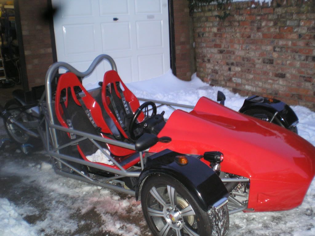

well you go away for a bit and lots of new posts to read with some good builds coming up too, one even pretty close to me as well which i will be reading with interest so lots of small things done best get some photos up  Firstly i have put my new welding skills to use. I wanted some solid fixing points for my sliding seat bracket.  sliding bracket with seat fixing points  seat all fixed in and working great
Post by anglais on Feb 12, 2012 17:14:20 GMT
 The much talked about clutch stop, again with my new welding skills, seems to work well as the cluch pedal hits it dead on giving it lots of strength no chance of bending again. Finally i have sorted the wiring on the cooling fan with the temperature sensor working on the dash now, also put a 10 pin connector on the wiring for the dash, so i can actually take the dash of and on which is a massive improvment. Havnt been able to test if the cooling fan kicks in at temp becasue the outside temp is so cold the engine hasnt been able to get hot enougth  All back together after digging it out of the garage! just need the snow to melt for a few test drives to fully check all the mods over the last couple of mounths, fingers croseed no more problems! Have
