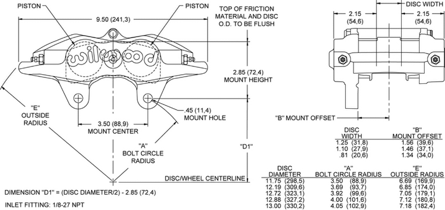

Am i drunk or did i get the wrong size brakdisc. the calliper wontfit. i have looked forpictures in the duch and venom build,but dident find anny that showed the fitting of the calliper, from the top side. Please let me hear what you guyes think. Hmmm. I am lookig into the calipers this weekend and i was told by Bas brake disc diameter is 253mm for rear ford focus wheels used for the front wheels on the Tr1ke. A random drawing from a Wilwood caliper shows this size disc is quite large: wilwood.com/images/Caliper/images_dimensions-lg/Forged_Superlite_Internal-cm-lg.jpgI am orientating for Hispec calipers and I would like to know what caliper you have and what spacer you need. Then I would be able to chose a smaller disc to match with the parts. I am not in favour for spacers like you. thanks in advance, Erik

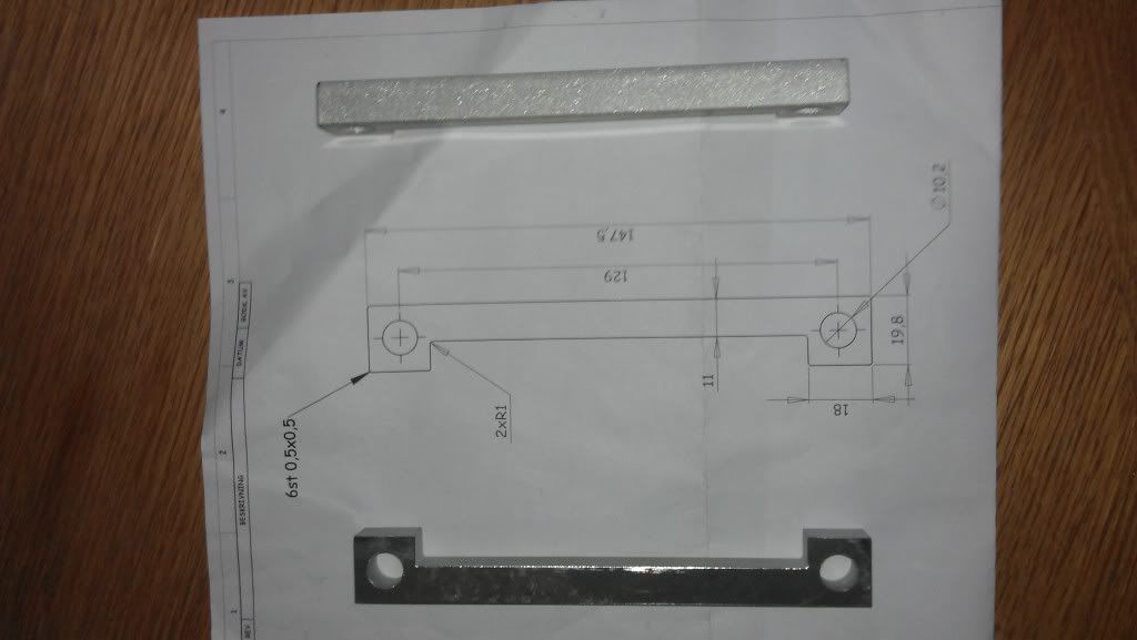

Brakespacer finnished nice to have access to a CNC watercutter. it left a space between disc and brake 2.5-3mm. paint will add 0,3mm
