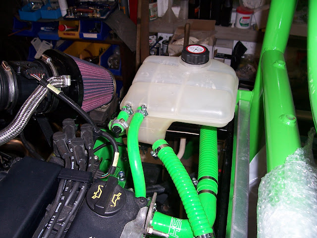

Looking for a bit of help. I'm working in the engine bay at the moment running handbrake cable cooling hoses gear cable. I'm looking to see if any Sonic builders can post some photos off the engine bay showing these parts. Also looking for photo's off the fuel filler pipe& cap.

Hi Andy, We have just got our 1.8 running last weekend. Here are some pictures of the cooling hoses.    Where the cooling hoses runs past the exhaust, we have made them in Alu pipe and that is now fixed to the bulkhead. Flexible hoses each end will allow for engine movement. (we hope) From memory, in the rear we are using: 4 x 32mm 90 degree bends 1 x 32mm 135 degree bend 1M x 32mm flexible hose 1 x T piece (2 x 32mm + 1 x 19mm ) 1 x T piece (3 x 19mm ) 1 x 1M 19mm flexible hose 2 x 1M 19mm Alu pipe 1 x 0.5M 9mm flexible hose When it came to getting air out of the system, it helped a lot when we lifted the back up. Our fuel tank is in the front so can't suggest on that one and we are still undecided on the handbrake cable routing as we have not yet made the final fit of the bodywork, we are still unsure of the best routing. For the gear change cables we went through the rear bulk head, 10cm or so up from floor level and dead center. That was a mistake as it is a bit close to the exhaust. A second attempt put the gear-change cables a bit to the passenger side and that gives better clearance of the exhaust and an easier bend radius for the cables. Looking at the cable routing in the cabin we may end up putting one cable through each hole and passing the gear cable either side of the handbrake. That said, this is just how we have done it and I'm sure there are others with more mileage under their belts who can offer more informed suggestions. We're based in Arbroath, so if your up that way just give us a shout. Hope that helps in some way. Guy

Post by andybaird on Jun 29, 2011 16:50:45 GMT
Thanks Guy
It gives me a few ideas.
